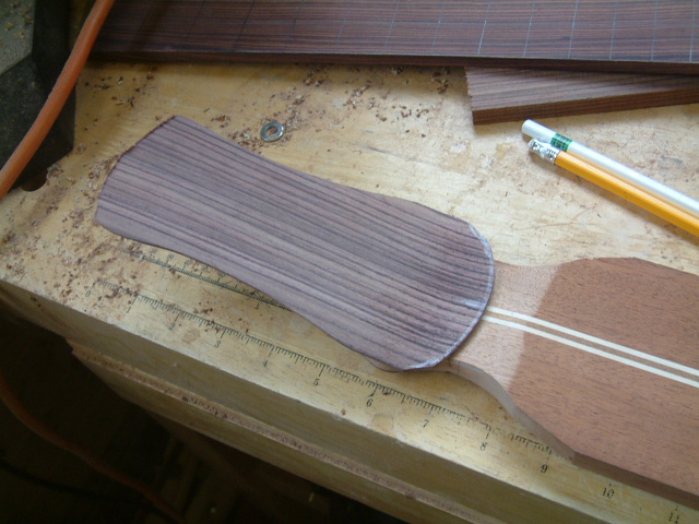

Hi guys, does any body have a good technique to glue a headstock back venner without a vacuum clamp? I just finished a neck and a nice zebrawood back venner will do the trick!

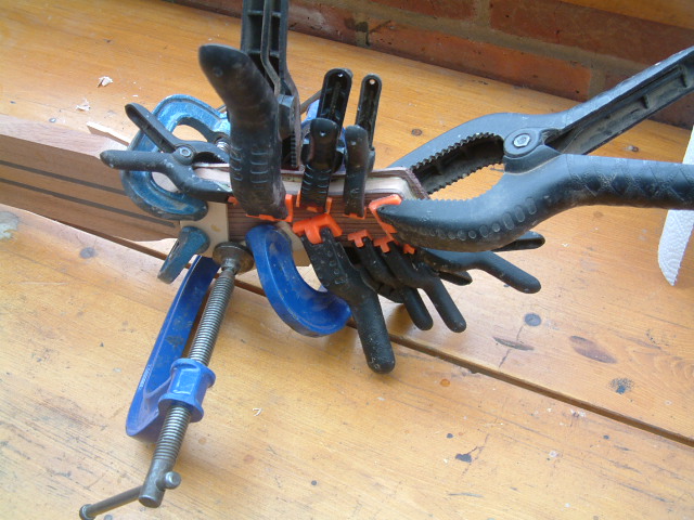

Peter,
I bend the veneer on my hot pipe to match the volute, rough shape it except for the back volute curve which I get pretty exact, and then glue with titebond and a multitude of clamps. I find I need to have a lot of clamping pressure at the back of the volute but not so much as the front hence the clamp mixtures. When the glue is dry I shape the veneer to the headstock - I sometimes use the beltsander, and other tines a piloted router bit:

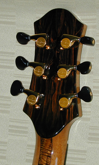

Hi Rod .. most of them never turn out well in photos, they all end up too dark to really show the grain and figure .. but here is a pretty good one. The photo again doesnt really do it justice.

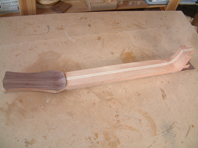

I used 1/16" birdseye maple veneer on the last one I did it without bending it first. I use a caul with wax paper/3/8" playground rubber/1/8" masonite and clamp.
